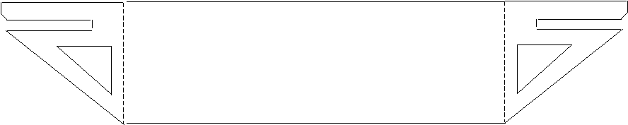

Why not something like this :

Sorry for the bad drawing : it has been done with Word...
So the rectangle would receive the catwalk texture, the triangular tabs would reveive a wood texture and the flaps slot into posts. It stores flat, as you only have to unfold the catwalk to store...

Would that maybe need a support in the middle Akmor? I'm guessing that the bits that go into the posts would stop the tendency for the tabs to rise back to flat.
Interesting. I must admit I was kind of thinking a lip at the front underneath the crenellations and make the catwalk part of that.
But your way could have a catwalk 1/2 way up a wall.

@Akmor - I like the simplicity of what you've thought up, but my gut tells me to go the TLX catwalk route. As I bash up the catwalk pieces, I'll try out your (perfectly well drawn!) idea just so people can see it in action and maybe get inspired to try it too. I think between removable post supports and anchors on both the top and bottom of the catwalk, I will get what I want. Here's a list of my reasons for wanting this:
1) It's already a part of the TLX system. I'll be following the files already present in the Lair of the Dragon God set, reusing the geometry and the cut files. 2) The catwalks have TLX tab slots and anchors. This means I can add posts and walls to them and I can add railings to them. This will come in handy for crenelations and hoardings I'm planning on using. 3) The catwalks use foamcore, so they will be nice and strong, and they will line up well with other floor tiles.
