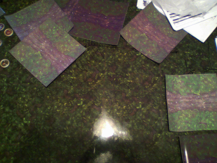

Awhile back I tiled the hinterlands artwork so that I could integrate a laminated mapsheet with certain builds, both in 2-D and 3-D. I assembled everything in Illustrator and handed it to a local printshop. It turned out surprisingly well and surprisingly dark. I usually don't do any color management work as I don't know enough to do it properly. Still like the sheet though.

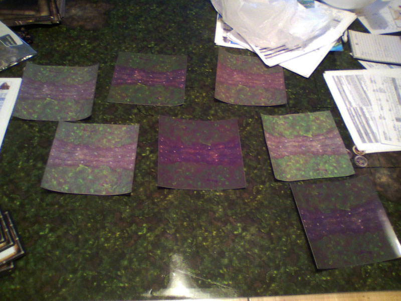

I tried printing out some of the paths and tried some color tweaking. I varied color temperature from red to blue, brightness up and down, and printed both on cardstock and a soft-gloss print stock to see if I could replicate what the print-shop's plotter did. I still can't seem to match it. I could probably do direct photoshopping, but I'd prefer to use the pdfs as stock as possible.
The main problem I see when comparing is that the cardstock will always look really washed out no matter the quality of the print. What's odd is that the semi-gloss samples I printed were nearly always washed and muddy (they look better on camera than in real life). The latter are the darker cut-outs in the middle and lower right of the bottom image.
Any suggestions on what I should do to make something that looks good against the mapsheet?

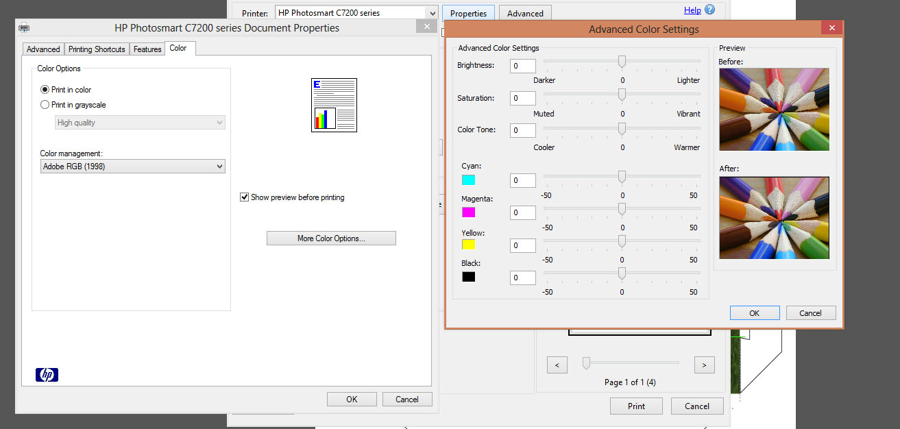

Actually these are the controls I have available. The other profile option I have instead of Adobe 1998 is sRGB. I'll keep experimenting, but I think I'll stick with the cardstock for durability reasons.
