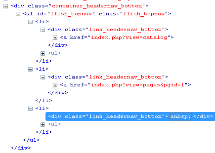

I fired up Firebug and it looks like the ones that work all have an anchor element within the div, but the forum div element does not.
[phpBB Debug] PHP Warning: in file /includes/functions_reimg.php on line 122: preg_match_all(): The /e modifier is no longer supported, use preg_replace_callback instead [phpBB Debug] PHP Warning: in file /includes/functions_reimg.php on line 124: array_unique() expects parameter 1 to be array, null given [phpBB Debug] PHP Warning: in file /includes/functions_reimg.php on line 126: Invalid argument supplied for foreach() [phpBB Debug] PHP Warning: in file /includes/functions_reimg.php on line 122: preg_match_all(): The /e modifier is no longer supported, use preg_replace_callback instead [phpBB Debug] PHP Warning: in file /includes/functions_reimg.php on line 124: array_unique() expects parameter 1 to be array, null given [phpBB Debug] PHP Warning: in file /includes/functions_reimg.php on line 126: Invalid argument supplied for foreach() [phpBB Debug] PHP Warning: in file /includes/functions_reimg.php on line 122: preg_match_all(): The /e modifier is no longer supported, use preg_replace_callback instead [phpBB Debug] PHP Warning: in file /includes/functions_reimg.php on line 124: array_unique() expects parameter 1 to be array, null given [phpBB Debug] PHP Warning: in file /includes/functions_reimg.php on line 126: Invalid argument supplied for foreach() [phpBB Debug] PHP Warning: in file /includes/functions_reimg.php on line 122: preg_match_all(): The /e modifier is no longer supported, use preg_replace_callback instead [phpBB Debug] PHP Warning: in file /includes/functions_reimg.php on line 124: array_unique() expects parameter 1 to be array, null given [phpBB Debug] PHP Warning: in file /includes/functions_reimg.php on line 126: Invalid argument supplied for foreach() [phpBB Debug] PHP Warning: in file /includes/functions_reimg.php on line 122: preg_match_all(): The /e modifier is no longer supported, use preg_replace_callback instead [phpBB Debug] PHP Warning: in file /includes/functions_reimg.php on line 124: array_unique() expects parameter 1 to be array, null given [phpBB Debug] PHP Warning: in file /includes/functions_reimg.php on line 126: Invalid argument supplied for foreach() [phpBB Debug] PHP Warning: in file /includes/functions_reimg.php on line 122: preg_match_all(): The /e modifier is no longer supported, use preg_replace_callback instead [phpBB Debug] PHP Warning: in file /includes/functions_reimg.php on line 124: array_unique() expects parameter 1 to be array, null given [phpBB Debug] PHP Warning: in file /includes/functions_reimg.php on line 126: Invalid argument supplied for foreach() [phpBB Debug] PHP Warning: in file /includes/functions_reimg.php on line 122: preg_match_all(): The /e modifier is no longer supported, use preg_replace_callback instead [phpBB Debug] PHP Warning: in file /includes/functions_reimg.php on line 124: array_unique() expects parameter 1 to be array, null given [phpBB Debug] PHP Warning: in file /includes/functions_reimg.php on line 126: Invalid argument supplied for foreach() [phpBB Debug] PHP Warning: in file /includes/functions_reimg.php on line 122: preg_match_all(): The /e modifier is no longer supported, use preg_replace_callback instead [phpBB Debug] PHP Warning: in file /includes/functions_reimg.php on line 124: array_unique() expects parameter 1 to be array, null given [phpBB Debug] PHP Warning: in file /includes/functions_reimg.php on line 126: Invalid argument supplied for foreach() [phpBB Debug] PHP Warning: in file /includes/functions_reimg.php on line 122: preg_match_all(): The /e modifier is no longer supported, use preg_replace_callback instead [phpBB Debug] PHP Warning: in file /includes/functions_reimg.php on line 124: array_unique() expects parameter 1 to be array, null given [phpBB Debug] PHP Warning: in file /includes/functions_reimg.php on line 126: Invalid argument supplied for foreach() [phpBB Debug] PHP Warning: in file /includes/functions_reimg.php on line 122: preg_match_all(): The /e modifier is no longer supported, use preg_replace_callback instead [phpBB Debug] PHP Warning: in file /includes/functions_reimg.php on line 124: array_unique() expects parameter 1 to be array, null given [phpBB Debug] PHP Warning: in file /includes/functions_reimg.php on line 126: Invalid argument supplied for foreach() [phpBB Debug] PHP Warning: in file /includes/functions_reimg.php on line 122: preg_match_all(): The /e modifier is no longer supported, use preg_replace_callback instead [phpBB Debug] PHP Warning: in file /includes/functions_reimg.php on line 124: array_unique() expects parameter 1 to be array, null given [phpBB Debug] PHP Warning: in file /includes/functions_reimg.php on line 126: Invalid argument supplied for foreach() [phpBB Debug] PHP Warning: in file /includes/functions_reimg.php on line 122: preg_match_all(): The /e modifier is no longer supported, use preg_replace_callback instead [phpBB Debug] PHP Warning: in file /includes/functions_reimg.php on line 124: array_unique() expects parameter 1 to be array, null given [phpBB Debug] PHP Warning: in file /includes/functions_reimg.php on line 126: Invalid argument supplied for foreach() home_page_div_issue.png [ 6.24 KiB | Viewed 27297 times ]
I'm pretty sure that's not the problem--it's just a modified take on the classic Suckerfish menu, and it worked fine in the multitude of browsers that I routinely check my own work in.
It's more likely to be a Javascript issue with iOS, but I'll stick an anchor pointing to the forum in there and see what happens.
The Community button now leads to the forum. It likely won't solve the iOS-specific issues fully, but you should be able to at least click the Community button to get to the forum. Can you confirm that this is the case?
